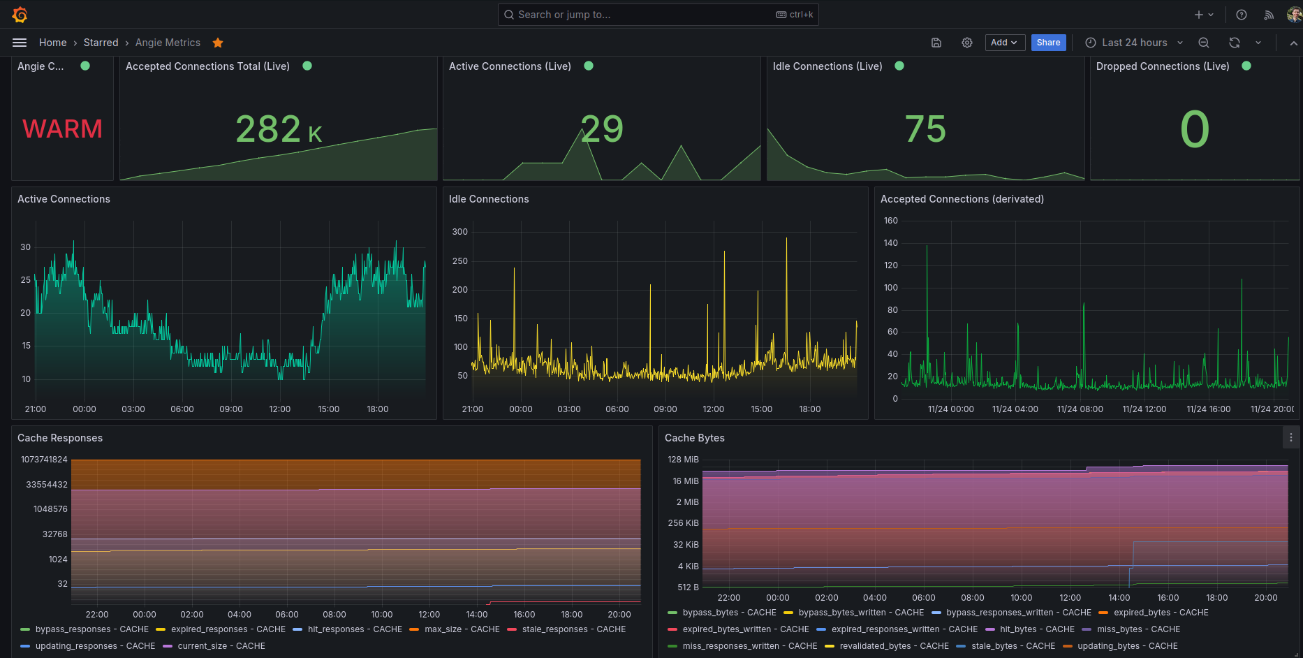

If you store your data in InfluxDB, then my Angie Telegraf plugin can also be used together with my Angie Grafana dashboard: Angie Metrics | Grafana Labs
